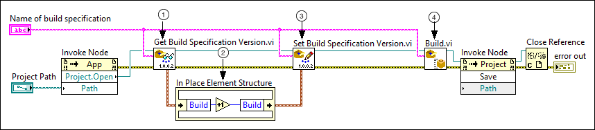

Der Prompt war:
Zitat:"In LabVIEW 2025, I want to create a vi that programmatically opens a project file, finds EXE build specification and allows to see the current build version. Can you help me with this?"
Und das Ergebnis:
Absolutely! You can create a VI in LabVIEW 2025 that programmatically opens a project file, finds EXE build specifications, and reads the current build version. Here’s how you can approach this, using the built-in Application Builder API:
Step-by-Step Guide
1. Open the Project File
Use the Project Open method (Invoke Node) to open your .lvproj file.
2. Find EXE Build Specifications
  • Use the Get All Descendents method (Invoke Node) on the project root reference.
  • Filter descendents by type "EXE" to get all application build specifications.
3. Read the Build Version
  • For each EXE build specification reference, use the Get Build Specification Version.vi.
  • This VI returns the Major, Minor, Fix, and Build version numbers.
Example Block Diagram
Here’s a high-level block diagram flow:
  1. Invoke Node: Project.Open: Opens the project file
  2. Property Node: Root: Gets project root reference
  3. Invoke Node: Get All Descendents: Finds all EXE build specs
  4. For Loop + Get Build Specification Version.vi: Reads version info for each EXE build spec
Visual Reference
[Bild: get-build-specification-version-vi.png?_LANG=enus]
Block diagram example from NI:
[Bild: loc_bd_typical_build_spec_version_vi.gif?_LANG=enus]
Key VIs and Methods
  1. Project.Open (Programming » Application Control » Invoke Node): Opens project file
  2. Get All Descendents (Programming » Application Control » Invoke Node): Finds build specs
  3. Get Build Specification Version.vi (vi.lib » AppBuilder » ab-api-simple): Reads version info
Common Pitfalls
  • Project Reference: Always close the project reference after use to avoid memory leaks.
  • Error Handling: Wire error clusters throughout to catch issues (e.g., missing build specs).
  • Saving Changes: If you modify build spec versions, you must manually save the project.
Next Steps
  • Do you want to see a sample VI or code snippet for this workflow?
  • Are you interested in reading or also updating the build version programmatically?
Let me know your preferred workflow, and I’ll help you build it out!
