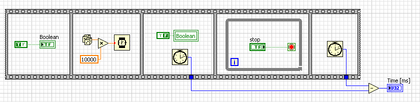

I'm trying to do some kind of reaction/speed test -game with LabVIEW. Basic idea is to test player's reaction speed.
Something like: Lamp is on, and after random time (1-10sec.) it goes out, and timer starts. When player presses some button the timer stops.
Then the program tells player's reaction time.
Has anyone done something like this? I would really appreciate some help!

Hi
This should help you.
Boolean is the LED indicator, stop is the button the user must push after is the LED became False.

' schrieb:Hi
[attachment=37237:ReactionTime.png]

Thanks! Just what I needed!
