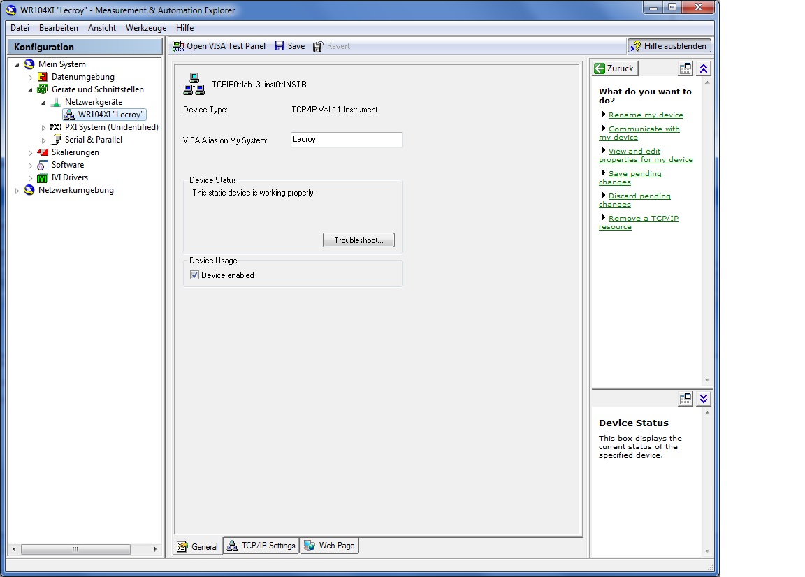

Ansatz: Daher habe ich mein Lecroy im MAX mit einem Netzwerk bereits hinzugefügt und Labview erkennt es auch als solches an.

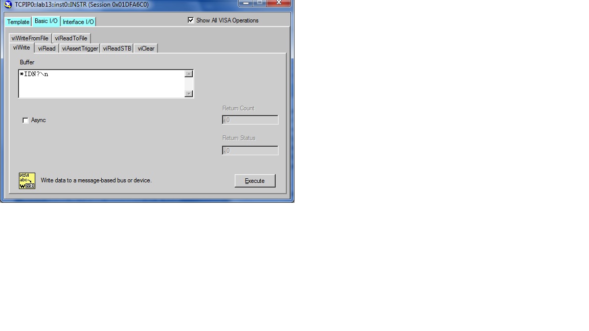

Im Visa Testpanel habe ich bereits mal was ausprobiert und er liest den Befehl der Identifikation aus. Jedoch habe ich bemerkt, das der Befehl *IDN?n mit einem zusatz versehen sein muss sonst gibt er einen FEhler heraus.

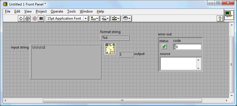

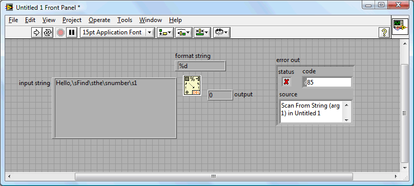

The "Scan from String" is looking for a decimal value and has some character (could be some text or non-printabel character etc.).
(Embedded image moved to file: pic20809.gif)
Here, I have setup my input string control to '' Codes Display so I could see spaces and carriage returns.
I get an error because I also have the words "Hello", "Find", "the", and "number" in my input string.
If I remove the printable text and leave the spaces, then I get:
(Embedded image moved to file: pic21148.gif)
Now, I see that the spaces are still there, but the letters are not. I can get my number from the input string with no errors.
There are a couple of ways to fix this.
If you already know what is causing the error in the input string, you can simply delete it from the string before the Scan.
You can use Scan from String in a loop to go through the string and filter out the number.

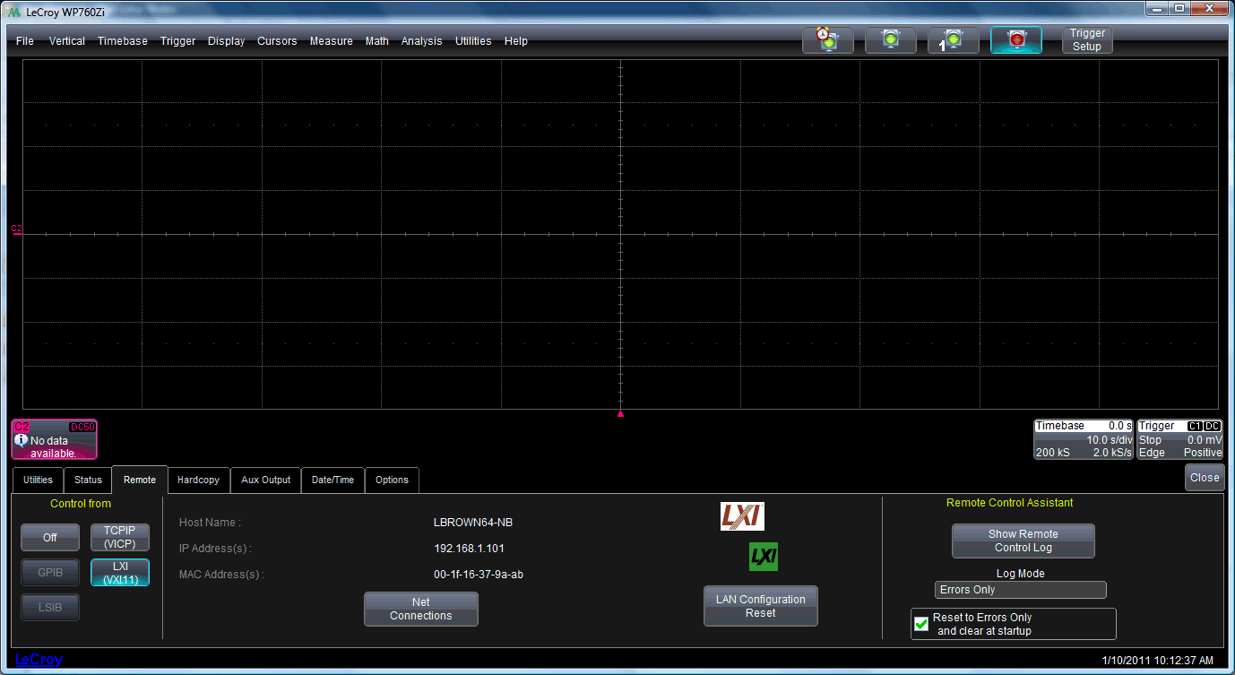

To setup the scope for LXI:
On the scope, go to UtilitiesUtilities Setup... from the pulldown menus.
Select the "Remote" tab and in the "Control from" area, select the "LXI (VXI11)" button.
(Embedded image moved to file: pic07120.gif)
Based on the error you are getting, it looks like you are connecting to the scope.

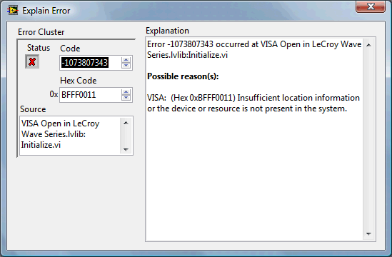

If you were unable to open the VISA session to the scope, you would see an error like this:
(Embedded image moved to file: pic08925.gif)

Im Grunde muss man folgende Schritte durchführen:
1. Scope Explorer Installieren (LeCroy Homepage)
2. Unter Utilities->Utilities Einstellung-> Remote (Fernsteuerung) auf LXI umstellen.
3. Unter Measurement & Automation den Scope unter Netzwerkgeräte hinzufügen.
Dann funktioniert das ganze auch. Die Prozedur braucht nicht geändert werden, so wie es im ni forum beschrieben ist.
DAnn sollte es von selbst funktionieren.
