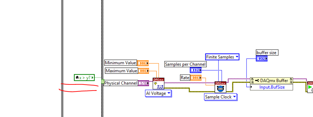

Maybe I need to set for the acquisition channel to read a specific amount of samples as you said (Please could you check the capture below).

What i did for the first case, just setting a fixed amount of samples to read. I need a dt =5sec, so for a sampling rate of 10000hz, i setted the amount of samples to (50000 S/ch)..
for the second case; i ve just used two successive read.VI, ( see below plz)

some comments on your image:
- Use AutoCleanup from time to time…
- You don't need a sequence structure here: THINK DATAFLOW!
- 10s is the default value for the timeout, you don't need to wire a constant (twice!) here…

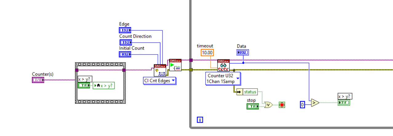

After many trials, I referred to an example to, trigger the measurements...so for every new rising edge I measure a set amount of samples. For this I am using a digital counter NI 9163 (0V-24V input).
When testing the code, the measurements are triggered even for a low voltage input.. (of 0.05V) due to a noisy signal !!!
I am so confused, and I am wondering, aside of this noisy signal... that there is something's wrong with the code BlushBlushBlush
I've attached below a capture for the counter channel.. and measurement channel ...

Zitat:I've attached below a capture for the counter channel.. and measurement channel ...
Why are there a control and an indicator using the VERY SAME label? (Why is it such a generic label?)
Which of those is used with the measurement part?
Which counter values do you get? How are they changing with time? Can you show a plot of these counter readings?
The counter probably is just counting up, so the comparison with zero will result always in TRUE…
Did you debug your VI(s)? Which value of "x>y?" is read before the measurement case structure?

@Jens, I am using the cDAQ-9184, The NI 9361 Digital input Module as a counter.
@GerdW, you are totally right Dais
In fact, the counter is counting up the edges, and the measurements are triggered since x>y is alway true comparing to zero.
This the problem, that's why even though there is now trigger signal it is still working :///
Please I am asking for help, in how to change this code in order to acquire measurement, for every coming rising edge...
