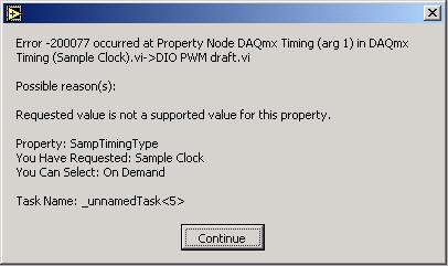

Thanks, I found the switch and I can now communicate from LabVIEW to my PXI-6070E card through the digital output. But it still doesn't work with both your programs because of a sample problem. I attached the error message box. So, I' d like to know if you have ever tried your programs with DAQ devices, and if it worked. Which devices did you use? And which version of LabVIEW?

i have tested it with a M-Series NI-PCI-6251,
i used LV 7.1 for this example ...

Last time, I had told you I had an error (-200077) and I found what was the problem : your program can't work with my 6070E because, I have found a exemple in LabVIEW (Cont Write Dig Port-Ext Clk.vi) with use the same VI as your program, and I get the same error. I ckecked out, the 6251 card that you used is in the list of hardware compatible with the exemple, but not the 6070E card. So I have to find another solution to generate a PWM signal to the DO line. I would like to know if you think that I can use the exemple "Write Dig Chan.vi" in replacing "Data to write" by a waveform which will be a PWM signal waveform and how can I do that ?

sorry, but this wont help.
take a look at the specifications of the card and you will see, that the PXI 6070E is only capable of 50 Hz DIO Input / Output.
And the write Single Chanel Solution will be slower, because it's software timed and you get an maximum resolution of 1 kHz, but it's not recommended to use software timing at this "high" sample rates anyway.
it seems, that you are not able to get this running with your card. The new M-Series DAQ-Boards are capable of 10 MHz DIO operations ... maybe you should contact your local NI sales representative?

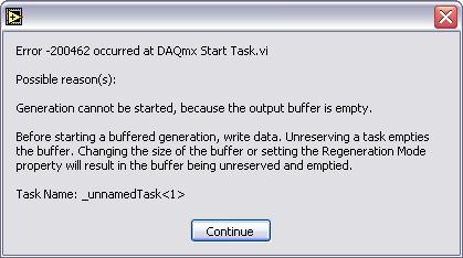

Hi i2dx, I hope you're still here because I have a problem and I need your help again. that's about the VI you gave me last time (DIO PWM 50Hz). As you told me, I had troubles because of the incompatibility of my hardware. But know, I received a new PSI and a new DAQ card ysterday. This is a PXI8187 embedded controller with a PXI 6229 multifunction DAQ. But I still have a problem, a new one. The error code is -200462 and it appears after the "create task VI" (see attached picture). Actually, it seems to be a software problem in opposition to my previous problems. But you told me, this VI works with you, isn't it ?
Please could you help me again, I am desperate 'cause of this project.
