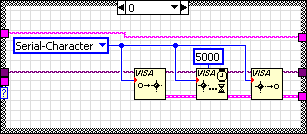

Hallo Leute, wie kann ich das VI Wait on VISA Event dazu bringen unendlich lange auf ein Event zu warten?
Ähnlich wie "-1" bei Queues.

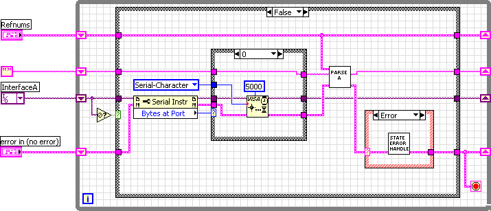

Noch was:
Error -1073807315 occurred at VISA Wait on Event in SK_Task_Read_Parse_A.vi->SK_Interface_A.vi->SK_Main.vi
Possible reason(s):
VISA: (Hex 0xBFFF002D) The event queue for the specified type has overflowed. This is usually due to previous events not having been closed.
24.04.2007 15:53:33 error: Error -1073807315 occurred at VISA Wait on Event in SK_Task_Read_Parse_A.vi->SK_Interface_A.vi->SK_Main.vi
Wie ist es zu verstehen? Was kann man dagegen tun?

P.S. hier das BD dazu

Wait on VISA Event
' schrieb:Hallo Leute, wie kann ich das VI Wait on VISA Event dazu bringen unendlich lange auf ein Event zu warten?
eg
Code:
VI_ATTR_TMO_VALUE
Resource Classes
All I/O session types
Attribute Information
Access Privilege Data Type Range Default
Read/Write
Local
ViUInt32
VI_TMO_IMMEDIATE (0);
1 to FFFFFFFEh;
VI_TMO_INFINITE (FFFFFFFFh)
Description
VI_ATTR_TMO_VALUE specifies the minimum timeout value to use (in milliseconds) when accessing the device associated with the given session. A timeout value of VI_TMO_IMMEDIATE means that operations should never wait for the device to respond. A timeout value of VI_TMO_INFINITE disables the timeout mechanism.
Notice that the actual timeout value used by the driver may be higher than the requested one. The actual timeout value is returned when this attribute is retrieved via viGetAttribute().
VDB
24.04.2007, 15:21
Wait on VISA Event
Hey, Danke VDB.
Es klappt aber leider nicht. Ich bekomme den Timeout-Fehler.
Error -1073807339 occurred at VISA Wait on Event in SK_Task_Read_Parse_A.vi->SK_Interface_A.vi->SK_Main.vi
Possible reason(s):
VISA: (Hex 0xBFFF0015) Timeout expired before operation completed.
24.04.2007 16:18:42 error: Error -1073807339 occurred at VISA Wait on Event in SK_Task_Read_Parse_A.vi->SK_Interface_A.vi->SK_Main.vi
eg
24.04.2007, 15:32 (Dieser Beitrag wurde zuletzt bearbeitet: 24.04.2007 15:33 von eg.)
Wait on VISA Event
Aber auch mit FFFFFFFEh geht es nicht. Komisch, spinnt es?
eg
EDIT es geht halt nur mit kleineren Werten, bis wieviel habe ich nicht ausprobiert.
24.04.2007, 16:36
Wait on VISA Event
Tja ich habe gedach ich bekomme damit
diese Fehlermeldung weg.
Possible reason(s):
Aber nein, ich weiss jetzt wirklich nicht, ob ich etwas falsch mache oder ob das Event-Mechanismus bei VISA noch nicht so reif und so fehleranfällig ist.
eg
24.04.2007, 17:22 (Dieser Beitrag wurde zuletzt bearbeitet: 24.04.2007 21:18 von eg.)
Wait on VISA Event
<strike>Ok, ich habe die Fehlermeldung mit dem Überlauf der Queue weggekriegt. Unendlicher Timeout funktioniert aber immer noch nicht.
