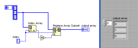

Hi all,
I'm quite now to Labview. I used Perl, Ruby, PHP and C before, but I have big problems to get used to work with Labview.
How can I port the following piece of code to my Labview FPGA VI?
There is a given index i and I want to increase the i-th array element. The array was initialized with zeros before.

Hi Robert,
you can use all these array-functions in LabVIEW with FPGA-Module:
Array Functions
http://zone.ni.com/reference/en-XX/help/...y_palette/
(18.11.2011 13:29 )RobertR schrieb:  There is a given index i and I want to increase the i-th array element. The array was initialized with zeros before.
Code:
array[i] += 1
I think the following example code should help you out:
Best regards,
NWO

RE: How to increase array element on FPGA
Thanks a lot!
