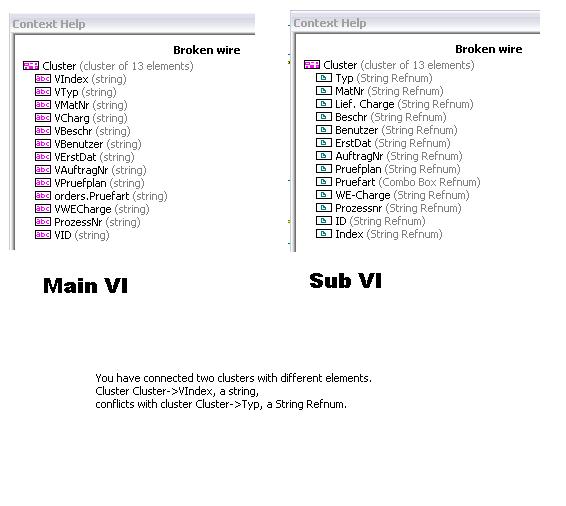

I have Main VI that contain a cluster of 13 elements (string)
I want to connect this cluster as an input to a subVI. See Attachment
But then there is this string --> String Refnum error. Can anyone please help

don't connect a cluster of strings to a cluster of string refs.
That doesn't works.
Have a look at my example.

you have connected two different clusters. That will never work...
In the main VI you use a cluster with several strings, whereas the subVI expects a cluster of references (of different types...)! You have to create a suitable cluster in the mainVI...
